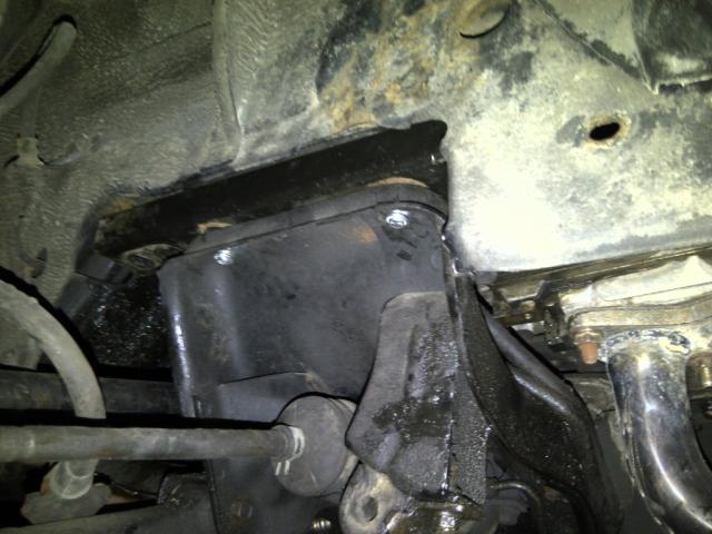

Dropped my front crossmember using cut down stock spacers from a 2000 outback

Outback spacees fit but the outback hardware is just slightly larger than the EA hardware. Doh. Just got new hardware. It'll do till I can get right sized grade 8

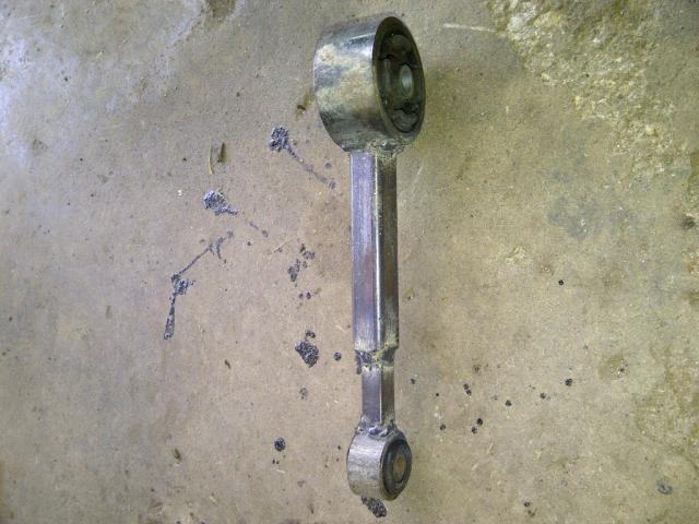

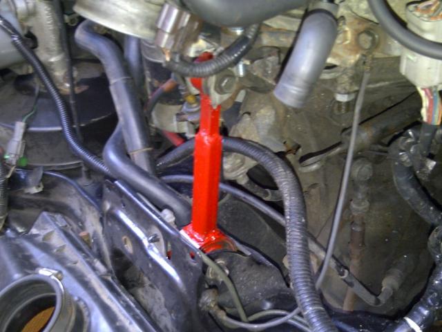

Made a new pitchbar for the lowered x-member. Welding could be bter but eh, who cares
driving the car with the crossmember lowered made a huge difference, since my suspension is kinda mushy, when i got on the gas the front end lifts up a bit from the ej25 torque and once i hit like 3000 rpms the power just wasnt there. well.. my axles were stretched out to the max. (already ripped a boot on my new F'in axle!; pre blocks)
the outback lift blocks lowered the crossmember probably like 1-1.25". the steering joint i used was from a 98 impreza, but the alignment holes were different so i had to pull my steering wheel and aim it right.
