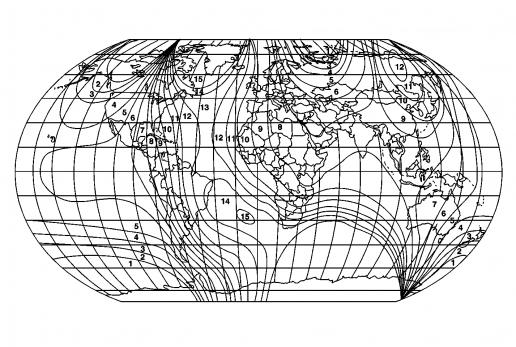

FlatFourFrenchy Posted June 16, 2012 Share Posted June 16, 2012 (edited) the compass is dead on when compared to my Garman GPS, I still need to mount the temp sensor, but will probably put it somewhere up front around the bumper area When you push button and end on direction hold it and numbers will appear. They are for setting zone. Look on a zone chart and pic the zone that you are in. Edited June 16, 2012 by FlatFourFrenchy Additional info Link to comment Share on other sites More sharing options...
Stubies Subie Posted June 16, 2012 Share Posted June 16, 2012 (edited) There's a couple of different charts, one chart shows me in zone 3, the other chart shows me in zone 4 there's two ways to set the compass, you can manually set it by zone number, there's 14 zones programmed into the compass, of you and press and hold the comp button until a "C" appears in the screen C= calculating, then drive slowly in a circle while holding the button until a compass heading appears on the screen, then the compass is set. when I manually set the compass by driving in a circle, it set the compass to zone 3. Edited June 16, 2012 by Stubies Subie Link to comment Share on other sites More sharing options...

1-3-2-4 Posted June 18, 2012 Share Posted June 18, 2012 There's a couple of different charts, one chart shows me in zone 3, the other chart shows me in zone 4 there's two ways to set the compass, you can manually set it by zone number, there's 14 zones programmed into the compass, of you and press and hold the comp button until a "C" appears in the screen C= calculating, then drive slowly in a circle while holding the button until a compass heading appears on the screen, then the compass is set. when I manually set the compass by driving in a circle, it set the compass to zone 3. On the US map version I would be driving between zones I guess it wont matter much? Link to comment Share on other sites More sharing options...

Stubies Subie Posted June 18, 2012 Share Posted June 18, 2012 On the US map version I would be driving between zones I guess it wont matter much? no, it won't matter if your borderline between zones. I'd set it by driving in a circle rather then picking zone from the menu. Link to comment Share on other sites More sharing options...
