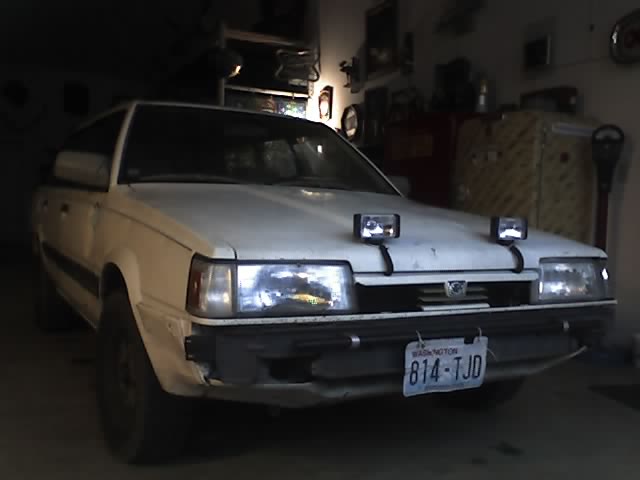

crazyman03 Posted December 28, 2009 Share Posted December 28, 2009 I put my new lights on! -Justin Link to comment Share on other sites More sharing options...

TheLoyale Posted December 29, 2009 Share Posted December 29, 2009 Justin, I have those same Baja Fox lights too. Mine are in front of the grille. How do they work on the hood? I'd like to put two round ones (4") one by each mirror (Rally safari style!) Looks good man. Link to comment Share on other sites More sharing options...
crazyman03 Posted December 29, 2009 Share Posted December 29, 2009 (edited) these baja lights are flippin' awesome imho . there is a *slight* vibration in the light due to bumps in the road and such since the hood is just a layer of sheet metal. other than that they are pretty nice. edit: they are far much brighter than the stock lights. i could *almost* drive with just them on. i wanted to put them on the bumper but decided against it. -Justin Edited December 29, 2009 by crazyman03 Link to comment Share on other sites More sharing options...
TheLoyale Posted December 29, 2009 Share Posted December 29, 2009 (edited) About the stock lights not being bright, what I found is, if you adjust both of them up about 1/2" to 1" or so, and out just a little they shoot out farther and wider (I did this to mine, very happy now) I'm also running 120/140w 5,500k Luminics Titainium white bulbs (9004) great bulbs (Very bright a project and eluminate awesome!) Just some insight incase you wanted some :-p -Tom Edited December 29, 2009 by TheLoyale Link to comment Share on other sites More sharing options...

crazyman03 Posted December 29, 2009 Share Posted December 29, 2009 About the stock lights not being bright, what I found is, if you adjust both of them up about 1/2" to 1" or so, and out just a little they shoot out farther and wider (I did this to mine, very happy now) I'm also running 120/140w 5,500k Luminics Titainium white bulbs (9004) great bulbs (Very bright a project and eluminate awesome!) Just some insight incase you wanted some :-p -Tom ya know, i have no idea what type of bulbs are in there right now. i bought it in September and all i had to do was replace the lens assembly. There happens to be 2 more in the door . I wanted to try and find some HID lights but i like what i have now. I wanted to also add that if you were to add (or if i were to...) a thicker piece of metal on the under-side of the hood it might prevent the lights from bobbing much. 'coarse they aren't really doing that much anyway but still.. -Justin Link to comment Share on other sites More sharing options...
TheLoyale Posted December 30, 2009 Share Posted December 30, 2009 ya know, i have no idea what type of bulbs are in there right now. i bought it in September and all i had to do was replace the lens assembly. There happens to be 2 more in the door . I wanted to try and find some HID lights but i like what i have now. I wanted to also add that if you were to add (or if i were to...) a thicker piece of metal on the under-side of the hood it might prevent the lights from bobbing much. 'coarse they aren't really doing that much anyway but still.. -Justin I would stay away from the HID conversions (From what I have seen and heard, they don't really provide alot more light) I would just change the bulbs to a better brand (Higher wattage) I mean the best bulbs I have ran are - "Sylvana Cool Blue" and the "Luminics Titainium white 120/140w bulbs" As for the offroad lights vibrating, you can use a rubber gasket or grommet on the top side of the hood/bolt to give it some support during bumps (I did this to the lights on my rack) and yes, a small metal brace would help aswell (makes the mounting area larger and stiffens that area. Its all up to you -Tom Link to comment Share on other sites More sharing options...
crazyman03 Posted December 30, 2009 Share Posted December 30, 2009 I would stay away from the HID conversions (From what I have seen and heard, they don't really provide alot more light) I would just change the bulbs to a better brand (Higher wattage) I mean the best bulbs I have ran are - "Sylvana Cool Blue" and the "Luminics Titainium white 120/140w bulbs" As for the offroad lights vibrating, you can use a rubber gasket or grommet on the top side of the hood/bolt to give it some support during bumps (I did this to the lights on my rack) and yes, a small metal brace would help aswell (makes the mounting area larger and stiffens that area. Its all up to you -Tom yea, about the larger surface area. thats what i was thinking. I do want to get higher wattage bulbs but i want to get a bigger battery. cant remember what size i got but its not very big on the amps. that.. and the nissan alternator conversion. i was going to pick one up at the junk yard yesterday but pickings were *very* slim. not many nissans OR 'roo's i only found 1 ea82, and it was a Loyale! i think i found a dl and that was it .. very sad times. -Justin Link to comment Share on other sites More sharing options...
TheLoyale Posted December 30, 2009 Share Posted December 30, 2009 Good luck with that My batt is 650CCA (Cold Crank Amps) get the highest CCAs you can (It'll save you in winter time) Hey, is there something on the driver-side fender? Looks to be in those pics. -Tom Link to comment Share on other sites More sharing options...

crazyman03 Posted December 31, 2009 Share Posted December 31, 2009 Good luck with that My batt is 650CCA (Cold Crank Amps) get the highest CCAs you can (It'll save you in winter time) Hey, is there something on the driver-side fender? Looks to be in those pics. -Tom the fender is actually tore up on the driver side. when i got it the whole headlight and marker light were banged up pretty good. replace the lights.. cut the fender up a bit to straighten it out and good as new. I wanted to go with a dual battery setup but as of late i haven't had the funds to do so. so that i can do anything i need to with adequate power, i'll probably get the upgraded alternator first though. anyway, OH! what have i done with my subie lately? I changed the water pump (went with a new one after all) and tomorrow hopefully i'm doing the passenger side wheel bearings. -Justin Link to comment Share on other sites More sharing options...

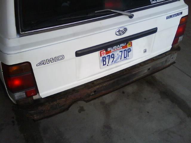

hardtail_pride Posted December 31, 2009 Share Posted December 31, 2009 ripped off my rear bumper plastic. Looking to make it a bit more capable off road, and then build a receiver to mount to the metal bumper, and through the storage compartment. Need to paint it tomorrow. Link to comment Share on other sites More sharing options...
crazyman03 Posted January 1, 2010 Share Posted January 1, 2010 Hey, is there something on the driver-side fender? Looks to be in those pics. -Tom Oh, I have My CB and Sirius Satellite antenna's on the driver door. that what you mean? -Justin Link to comment Share on other sites More sharing options...
TheLoyale Posted January 1, 2010 Share Posted January 1, 2010 Oh, I have My CB and Sirius Satellite antenna's on the driver door. that what you mean? -Justin Oh thats what I must see, Yea I figured it had to be an antena for some gadget (Whats a Subaru without them? Lol) -Tom Happy New year everyone! I made it to see 2010 (Now wheres 2525?) Haha Link to comment Share on other sites More sharing options...
