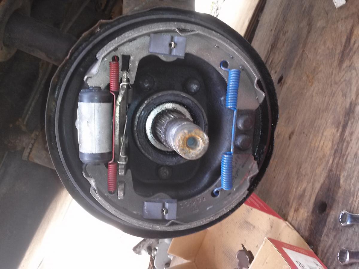

Twitch de la Brat Posted June 16, 2014 Share Posted June 16, 2014 Have had an ongoing squeak/squall for a while. I investigated my front brakes thinking they had gone bad. They still have over half life on them.Continued investigating the squall, and realized the driver's side axle nut spun off by hand. Previous person who worked on it hadn't cranked it down properly. Popped the hub off and there was rust and a shiny metal bearing race where it had been rubbing. Hooray for incompetency. So now I get to return the brake bits and keep the bearings for install. The shop that owned this car will not be getting any references ever again. No pix yet, but pretty much everyone knows how to pull an EA82 hub apart to replace bearings. Zeh Vedge shall be silent again soon! And F/4WD drive as well, as I will reinstall the other axle. Twitch Link to comment Share on other sites More sharing options...

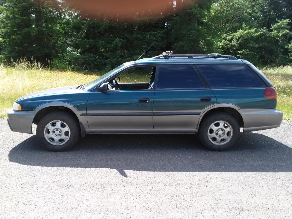

TallonX Posted June 19, 2014 Share Posted June 19, 2014 How bout what have you done to A subi lately... Just finished lifting a buddy's Outback, Forrester strut assembly and 1" spacers. Overall lift 2.5-3" 1 Link to comment Share on other sites More sharing options...
