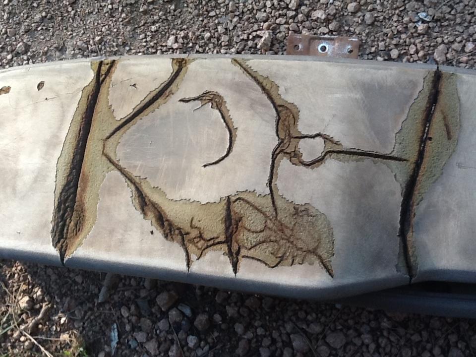

spazomatic Posted October 28, 2014 Share Posted October 28, 2014 Oh and ive been tinkering with rehabilitating my poor dashboard since its out. Used a cheese-grater looking body file to getbthe horrendous high spots out that were around each crack, sanded it all out, and used caulking to fill 'em in. Sanded again then skimmed on another coat of caulking (it shrinks a bit). Not done yet, need to sand it out one more time, then top coat it. (With what, i havent decided) Heres before After roughed in sanding And how it sits right now Link to comment Share on other sites More sharing options...
