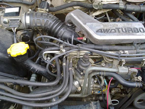

Sonicfrog Posted January 16, 2010 Share Posted January 16, 2010 (edited) OK. Here's one for you. Those of you who have an EA engine, and HATE the perpetually loose oil cap? Ever wonder if an EJ oil fill spout would fit on an EA82T? YEP!!!!!!! You have to drill the bolt holes a bit bigger. The EJ tube has an o-ring slot. You might be able to find a big enough o-ring to seal it. I didn't and was in a hurry, so I simply made a gasket for the engine / oil fill tube. Edited January 17, 2010 by Sonicfrog Link to comment Share on other sites More sharing options...
Turbone Posted January 17, 2010 Share Posted January 17, 2010 But its plastic My Brat started paying me back today, I put it to work. Link to comment Share on other sites More sharing options...

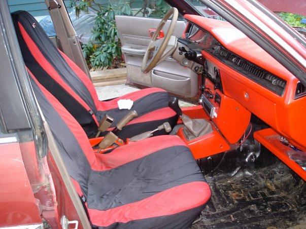

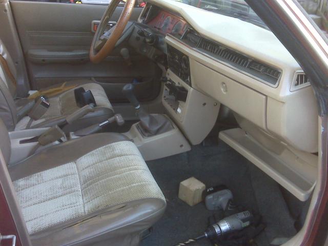

'84 Flat-Four Posted January 19, 2010 Share Posted January 19, 2010 I de-riced my 84 wagon This has been a long time coming... believe me I was sick of that red! Before & After pics... 1 Link to comment Share on other sites More sharing options...
TheLoyale Posted January 19, 2010 Share Posted January 19, 2010 Wow! Looks good - how did you paint the dash while in the car? I assume you painted it, yeah? -Tom Link to comment Share on other sites More sharing options...
'84 Flat-Four Posted January 19, 2010 Share Posted January 19, 2010 Thanks! Yes painted it with regular spray paint (for-exterior-plastic application) Valspar brand. Primed it first. The dash involved taping newspaper to the windshield and trash bags in the compartment area. one coat of primer and two coats of paint done with one can of primer and two cans of the tan paint. For the detailed tricky areas, I sprayed paint into the cap and used a small paint brush. But all the rest was piece of cake disassembly and paint away... Link to comment Share on other sites More sharing options...

'84 Flat-Four Posted January 19, 2010 Share Posted January 19, 2010 at the time of purchase I didnt mind or care really... but after a while I realized my blood-pressure was rising each time I got in the Soob... much more relaxing color Link to comment Share on other sites More sharing options...
