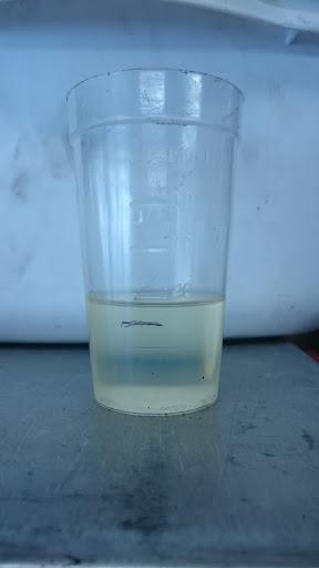

coronan Posted June 28, 2015 Share Posted June 28, 2015 (edited) So 2 of my injectors have poor mist pattern. No turbo cars listed above were at my pick n pull. But i did get my hands on a 84 maxima (inline 6) Based on post 7 I thought VG30E injectors would work on my EA81. I cleaned em up and they sure do mist nice. BUT... With a crude flow test they do not flow nearly what the stock ea81 injectors do. My test is 40 psi with 10 sec On with a stop watch. Stock EA81 injectors flow about 37 ml (fluid in the cup) VG30E injectors flow about 30 ml (Black line marked on the cup.) Word to the wise. Dont make my mistake. Edited June 29, 2015 by coronan Link to comment Share on other sites More sharing options...

coronan Posted July 1, 2015 Share Posted July 1, 2015 Both my poorly spraying spraying Subaru injectors and the nicely spraying Maxima injectors flow incredibly consistent, one injector to the next. If i wanted to get scientific about it I could weigh the fluid. But i'm not racing and my heads are not flow balanced so what is the point of balancing injectors if the cylinders have different air flow. I had them out so I wanted to know they are clean and have good spray pattern. I did put my better spray pattern injectors in the higher flowing intake ports. (for now... Gotta get this thing back on the road.) I am familiar with adjusting the MAF from playing with toyotas. Surprisingly it does not get discussed on this forum. I'm wrapping up a head rebuild. After this I will have wide band AF gauge installed. The other thing that does not get discussed is if upgrading the injectors is fixing a lean issue, OR its just because all the cool kids are doing it. For example no one in this thread mentions knock or ping. Link to comment Share on other sites More sharing options...
